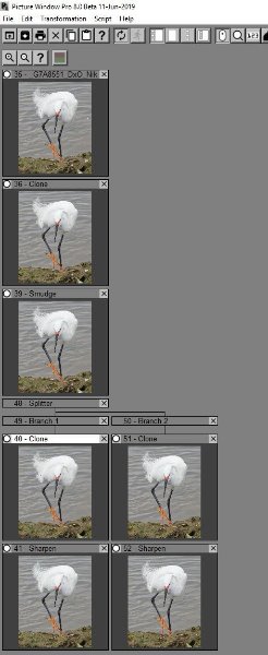

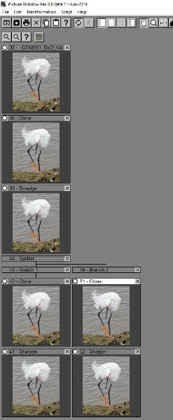

Just saw this problem where the cloned side-branch does not exhibit the same Clone-Tool results as the original. The images illustrate the problem.

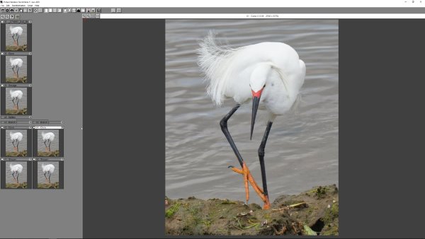

These images hopefully are readable. The workspace file is attached in zip format. When I exited PWP 8 and restarted with the workspace file, only the erroneous cloning result appeared in both branches.

It looks like this can be caused by leaving a transformation located above the splitter open so its result is not yet propagated through the image tree. When you click OK on the open transformation, the differences disappear.
I'm still thinking about how to fix this, possibly by forcing a recalc of all the branches of the splitter after cloning the side branch and not just the new branch. Or possibly by forcing you to close all the transformations above the splitter.
Let me know if this is not the cause of the problem you are seeing and I will investigate further.

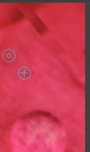

Using the Clone Tool again and on occasion the tool flies off to the upper left on its own. See attached screenshot.
Re: Clone-Tool Issue with Cloned Side Branch
Posted: June 16th, 2019, 7:18 am
Any idea how to reproduce this?

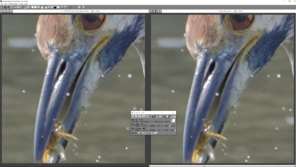

On a maybe related note. My Speck Removal tool has stopped working completely. It worked once following the use of the clone tool, but now there's no tool appearing. I exited PWP and restarted it. I re-booted the PC. I even uninstalled PWP 8 and re-installed. Nada.
Missing Speck Removal Tool.jpg (32.32 KiB) Viewed 8544 times
As shown in this screen-shot, the Tool window appears, but doesn't interact with the image.

For the speck removal tool, try three things:
1) Click on the title bar of the Speck Removal dialog box to activate it.
2) Unlike Paint and Smudge, you have to Shift-Click on the image to create a new point. Unshifted click is used to select existing specks so you can reposition them.
3) Unlike Clone, you click on the input image and not the output image.
