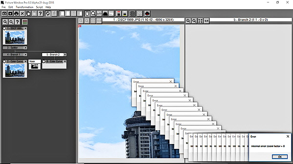

Internal Error: Zoom Factor = 0
Ref: PWP 8.0.exe 180821 with msi 180816
1) Open and image in the Browser
2) OK a Color Curves transform with mask
3) Add a Side Branch to Image 1
4) Attempt to Open Color Curves on Branch 2... ...Error occurs.
Internal Error - Zoom Factor equal 0.jpg (137.71 KiB) Viewed 1464 times
Closing all of the Error boxes or End Task [PWP8] with the Task Manger is needed to restore normal system operation.
