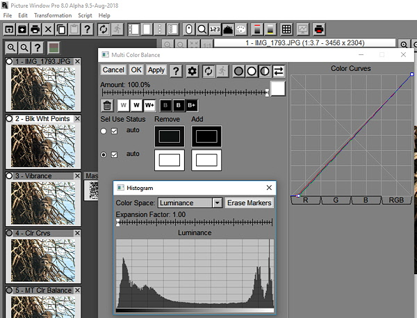

Before transform Reset:
MultiClrBal initial script settings.jpg (231.13 KiB) Viewed 1643 times
image 2 Command info before Reset:
multi_color_balance 0 npts 2 white 2 black 2 probesize 1 curpt 1 amount 1 -1 0 0 ″Amount: ″ ″Mask″ display 2 sync_scroll 1 auto_preview 1 enable1 1 inconsistent1 0 src1 0 dst1 0 enable2 1 inconsistent2 0 src2 fefefd dst2 ffffff

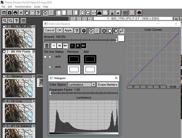

After transform manual Reset:
MultiClrBal after Reset settings.jpg (226.79 KiB) Viewed 1643 times
image 2 Command info after Reset:
multi_color_balance 0 npts 2 white 2 black 2 probesize 1 curpt 1 amount 1 -1 0 0 ″Amount: ″ ″Mask″ display 2 sync_scroll 1 auto_preview 1 enable1 1 inconsistent1 0 src1 11120e dst1 0 enable2 1 inconsistent2 0 src2 ffffff dst2 ffffff
