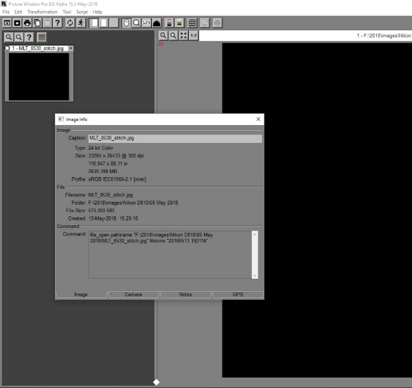

Tried again with 15.5-May-2018, to open my large file. No more crashing, it opens quickly, but it's all black:
I could resize it to a smaller size, but it is black, too.

By experiment, I am guessing the size limit is around 32000 x 32000 24-bit color pixels. I was able to make a checkerboard image that large and save and reload it, but 40000 x 40000 did not work. 40000 x 40000 8-bit black and white did work.
