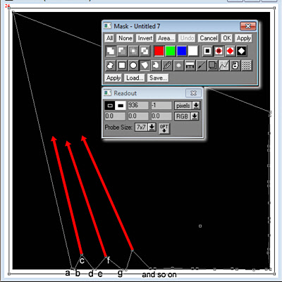

First method:
Step1:
a) Open an image on which apply the light beam.
b) Open Mask - New - Polygon.
c) Place one of the initial control points towards where the light comes, for example, the left top corner, and even beyond. Draw the opposite corner in the opposite angle and the two other points on each adjacent dimensions, according to the light desired angle.
d) Place control points all the way along these, with dimensions according to the distribution: 2 points closer, 1 spaced point, 2 closer points, 1 spaced point, and so on. One must have two points closer at each end. The closer points must be separate by 25 to 30 pixels to avoid artefacts which I saw appearing when these points are not doubled or if they are too much closer.
e) Draw on the spaced points in the direction of the origin point from the rays, according to the following diagram, without never the lines are touching nor cutting. When the rays appear well distributed, Apply creating Mask1.
Step2:

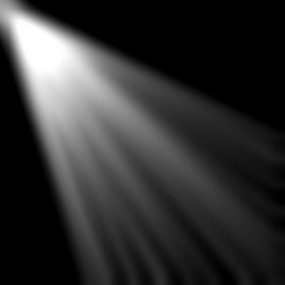

Click on Mask1. Open Blur Transformation - Gaussian
Radius = 15 to 25 according to the thickness of the rays
Threshold = 90 to 100 to avoid artefacts.
OK Creating Mask2
Step3:
Click on Mask2 - Open Gradient Transformation
Level = 30 to 40
Type = Multipoint
Operation = Filter
Color = black or color of choice.
Move the four control points to obtain the desired gradient (position and intensity).
OK creating Mask3
Possibly, extend to full dynamic range.

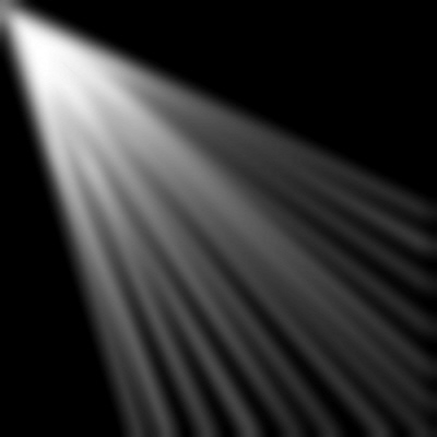

Second method (Faster):
The first step is the same than the first method, but without leaving the masks Tool, after having drawn the mask of beams,
Step 2b : Do Feather= 25, Apply, then Blur = 5 to 10, and Apply; OK creating Mask2b.

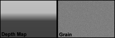

...my wife and niece recently returned from a visit to southwest USA's 'canyon country' with the obligatory 'olde time western' staged saloon studio tourist [and pricey] digital print produced with rudimentary post-processing software...
(1) the print was scanned, then adjusted for full range, contrast, and color...
(2) the resulting (1) image was depth-mapped guassian blurred and grain added...
(3) the resulting (2) image was Hard Light filter blended with the alternate suggested 'Customized Light Beams' template that had been Composite-Blended with DieterM's sky/cloud texture where Color 1 was changed to a 25% Gray [see: http://www.dl-c.com/cgi-bin/discus/show ... #POST28665].
This texture template is available for download at http://www.ncplus.net/~birchbay/tutoria ... eams01.htm if of interest...
Post 1 of 2 -- to be continued...
Custom Light Beams and other Textures
Post 2 of 2 -- continuation...
(4) the main subjects of the resulting (1) image were one-to-one cloned into the resulting (3) image version, producing...
...to me this image version has a greater sense of depth, varied lighting, and suggests the uneven fading and grain that an 'old' photograph might exhibit... ...perhaps a more interesting image than was originally purchased... ...and exploring possibilities
