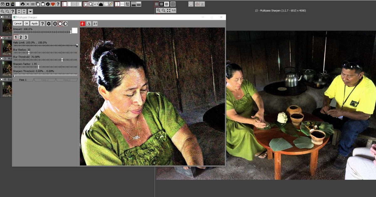

Maciej,
I am trying but struggling.
My first problem is dealing with the white/black sliders for Halo Limit and Sharpen Threshold. If I need to slide them both I struggle with my cursor.
I there any way I can make the whole Multipass Sharpen control window permanently larger. That little preview window is so important that I could do with it using half my screen.
This is a really noisy shot and I need this amount of preview.
Wed 1.jpg (170.21 KiB) Viewed 9766 times

Isn't using that Show Differences a key to seeing what is happening?
