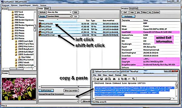

I routinely batch process the following EXIF tags using ExifToolGUI to multiple image files [CR2, JPEG, and TIFF] contained in a folder:
-LensType#=234 -Exif:LensModel="Canon EF-S 17-85mm f4-5.6 IS USM" -Exif:LensInfo="17 85 4.0 5.6" -Exif:Artist="...den..." -d %Y -Exif:Copyright<"(c) $Exif:DateTimeOriginal IMAGEs by DEN" -Exif:ImageDescription="-"
ExifToolGUI and Part 3a Command Line Option set.jpg (82.34 KiB) Viewed 6613 times
Perhaps you could do something similar with the tags of particular interest to you.
There is a dated 2013 pdf [750 KB] describing what I do if of interest that I could upload to my website for your download.

Thanks. I realize that exiftool is the software that is under the hood for many of the metadata editors around, so I probably need to learn the syntax, I have just been lazy. exiftool for photos reminds me of ffmpeg for videos -- it's to go-to software for its purpose, just a steep learning curve for all the syntax and options.
I just started looking at ExifToolGUI again, had been concerned that it isn't being supported, but maybe that's not an issue. Thanks for the recommendation.
