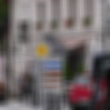

I've been doing something similar with AS, not knowing the name for it...
I always wandered why I usually liked the results using AS more than BS. It may have something to do with the 'un-thresholded' blurring step producing different results.
The advantage of BS is that it seems faster than it used to be, and also faster than AS for large radii.
AS 16
AS 16
300 Crop AS Blur 16.jpg (11.68 KiB) Viewed 3007 times

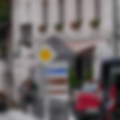

BLS R20
BLS R20
300 Crop BLS Blur 20.jpg (10.49 KiB) Viewed 3005 times

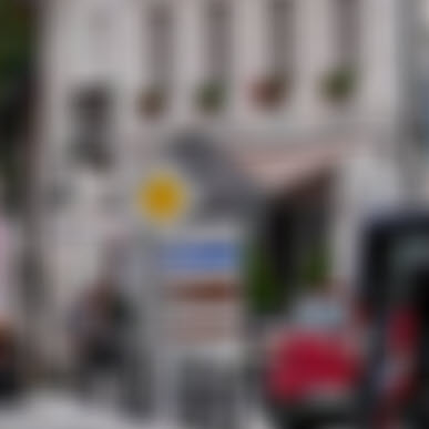

Original
Original
300 Crop Original.jpg (43.79 KiB) Viewed 3002 times

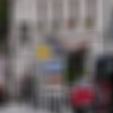

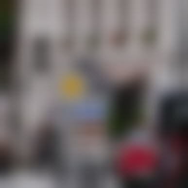

Just out of curiosity, 3 different blurs of the original crop of Jonathan's image, with radius 16. The radii may not mean the same thing between the blurring methods, I imagine, but the results are visually different because of the blur computations, not only the amount of blur.
c.f. AS and the original from the previous post.
Bilateral Sharpen 16 (blur)
BLS Blur 16.jpg (11.41 KiB) Viewed 2993 times
Precise Gaussian Blur 16
Precise Gaussian Blur 16.jpg (12.34 KiB) Viewed 2993 times
