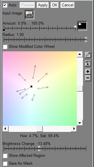

Applying the following selective color correction also helps the image when using a mask to confine the correction to the upper left quadrant. The correction slightly increases the saturation of colors near white without changing their brightness and reduces the brightness of pure white by about 15%.
- Correction.jpg (96.67 KiB) Viewed 13832 times

Thanks Robert.
Another good idea.
Tony
Another good idea.

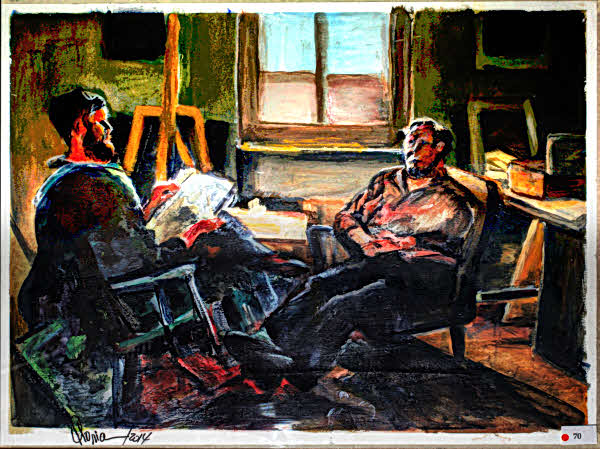

This is the print with the shine at the two top corners.
http://www.tonygamble.uk/aaShineProblem/SDIM0606.jpg
I get as far as this. Can someone tell me, or post a screenshot of what I should do when I get to here?
http://www.tonygamble.uk/aaShineProblem/Shine.JPG
All help appreciated as usual.
Tony
