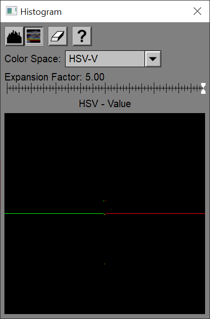

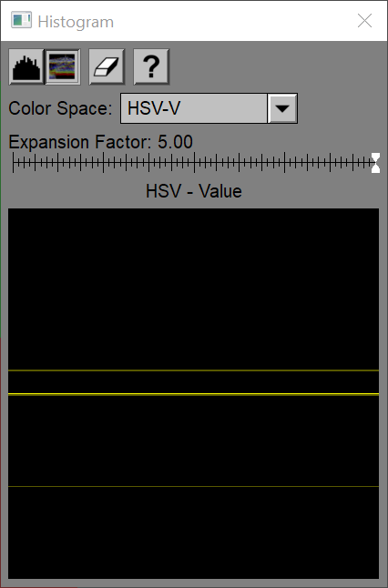

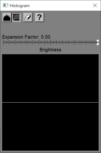

While this is just an artificial image that I'm using to learn, I can't figure out why those multiple lines exist. The colored waveforms are from green/red images above (vertical and horizontal), the B&W one is for extracted HSV-V channel of either of those images. I understand the B&W one, I think.

When you crank expansion up to 5, single pixels will show up, even though they are not significant in how the image looks. The code that computes the waveform first resizes the image the get a reasonable number of pixels to work with. In the examples you are using, this can create some false colors at the transitions between blocks of solid color and these are showing up as extra lines when you expand the histogram. On a normal photographic image this would not be an issue.
