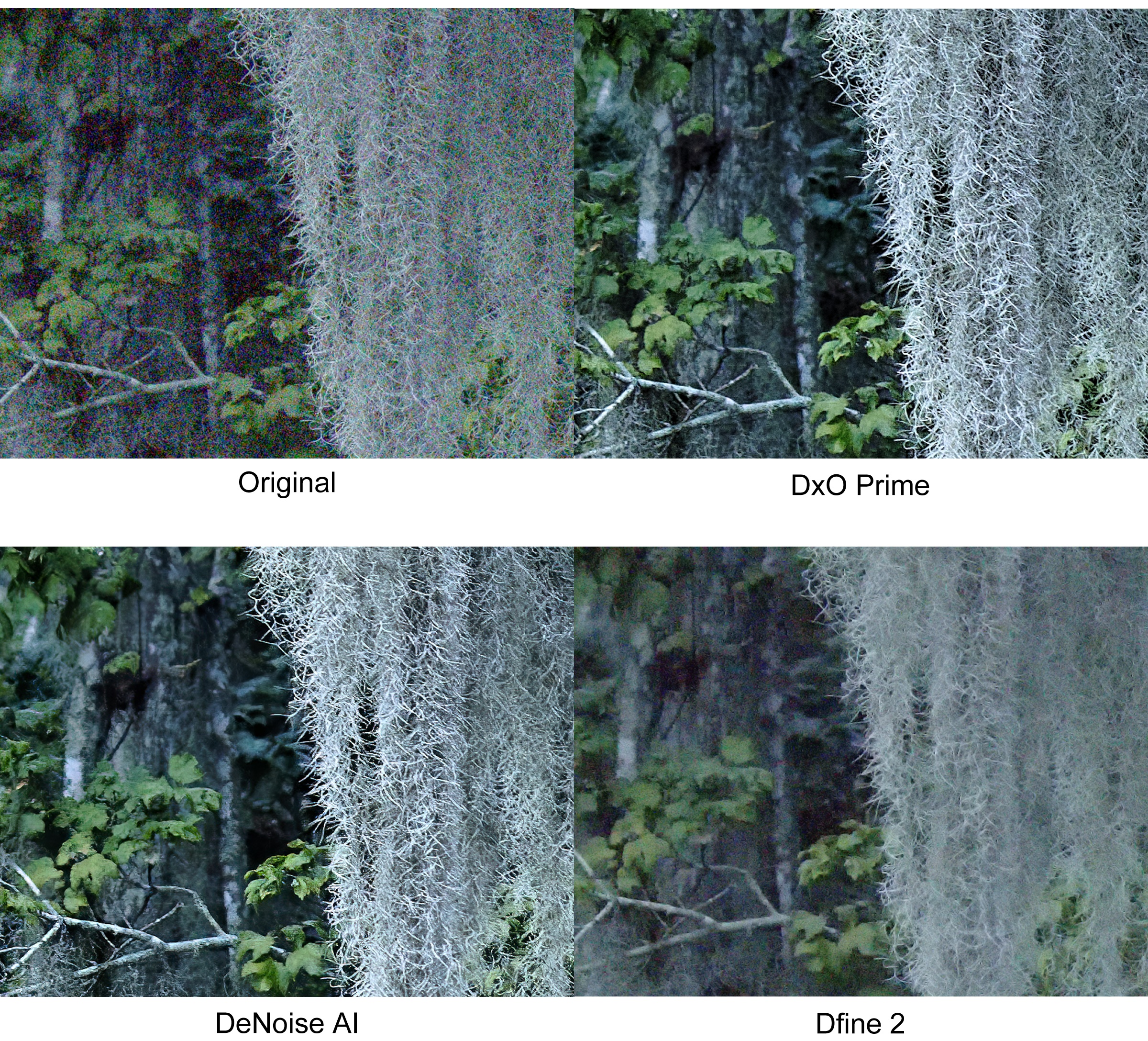

Does anyone have experiences how Topaz DeNoise AI performes compared to DXO Prime or NIK Dfine 2?
I guess DXO Prime works just with RAW.
Posts: 4908
Re: Topaz DeNoise AI
I just tried using all three using their default settings on the same very noisy image - not a scientific test by any means. The original was shot at ISO 2000 and the exposure increased by 3 stops using DxO PhotoLab.
Both DxO Prime and DeNoise AI produced very similar results. Dfine 2 was much worse. Since each noise reduction method has settings you can adjust, it is possible the rankings would be different if you were willing to spend time fiddling with the controls.
DxO can open and apply noise reduction to TIFF or JPEG files, although I believe you probably get slightly better results starting with RAW files.
You can see the comparison at http://www.dl-c.com/Images/Noise%20Reduction.jpg
