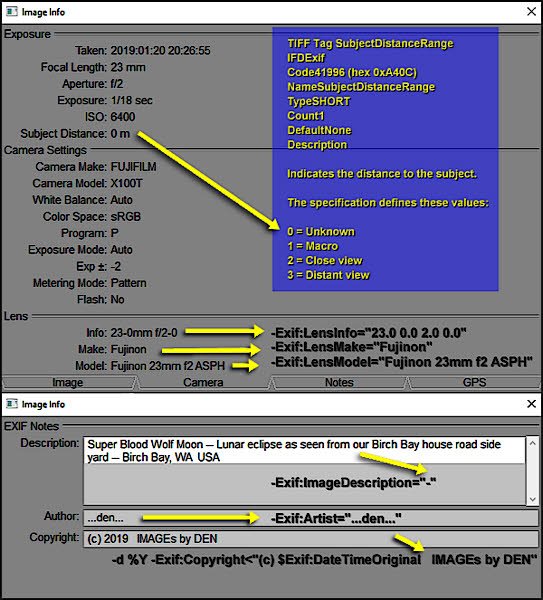

Ref: PWP8.0.exe 10.5 Feb 2019
1) I agree with Winfried... ...do not try to became a major meta data editor...
2) FYI current "Image Info" data for a Fujifilm X100T camera:
PWP8 Image Info-Lens-Notes and ExifTool.exe Options-1-1.jpg (82.1 KiB) Viewed 6729 times
a) Subject Distance should be "Unknown" if the tag SubjectDistanceRange is used by PWP8.
b) Lens Info, Make, and Model are not past on to the tiff conversion file by Fuji's Raw File Converter Ex 2 program so they must be manually added.
c) Description, Author, and Copyright must be manually added.
d) I do not utilize GPS coordinates.
I will use ExifToolGUI v5.16 with ExifTool v11.2.6.0 to batch process jpegs, tiffs, and RAF, CR2 files with the desired meta data changes. While ExifToolGUI is not maintained, it still will work with the latest ExifTool.exe version for the minimal preference changes.

You are confusing Subject Distance with Subject Distance Range which is a different Exif tag. Subject Distance is in meters, although 0 is supposed to indicate unknown and not 0 meters.
Each camera supports its own collection of tags. The missing ones will show up blank.
