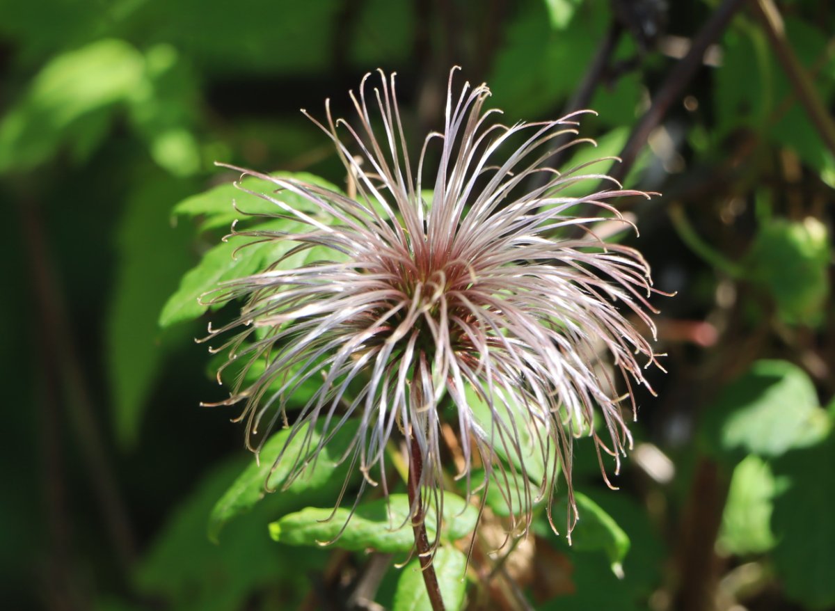

I've been trying different ways of creating a mask that only preserves the core clematis flower. I've had varying degrees of success vs effort involved, so I was wondering if anyone had some neat tricks or transformations that I'm not familiar with. A sample image is attached.
Thanks in advance for any insights or tips!

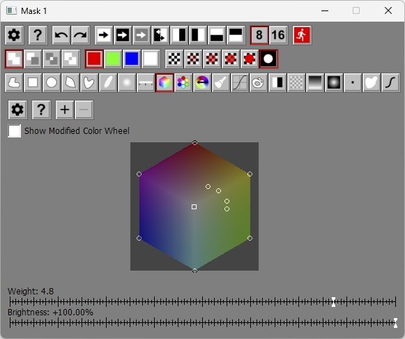

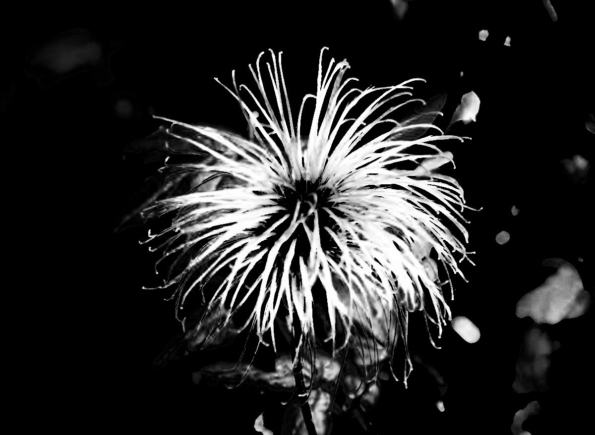

I was able to get an imperfect but possibly useful mask.
I built the mask in two stages -- first using the Hue Saturation mask tool and setting a high brightness and weight on the white control point in the center and adding a few other control points with 0 brightness to remove the orange, yellow and green parts.

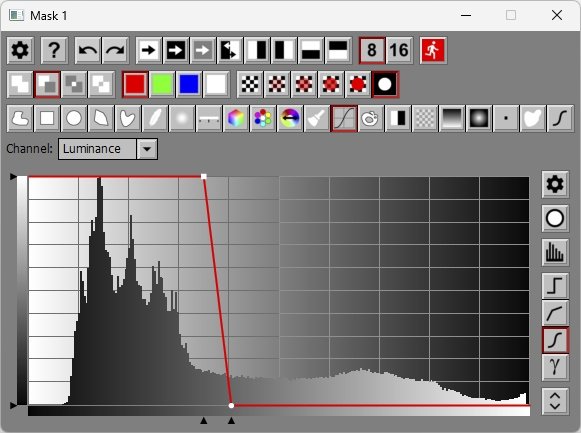

Then I used a Brightness Curve mask tool in Subtract mode to remove the darker parts of the previous mask.

Re: Masking technique sugestions???
Each control point has a Weight and Brightness slider. The current control point is displayed with a square and its weight and brightness settings are displayed in the sliders.
To include a color in the mask, set its control point's Brightness to a high value. To include more colors around the control point, increase the Weight. To exclude a color, set its control point's Brightness to zero.
