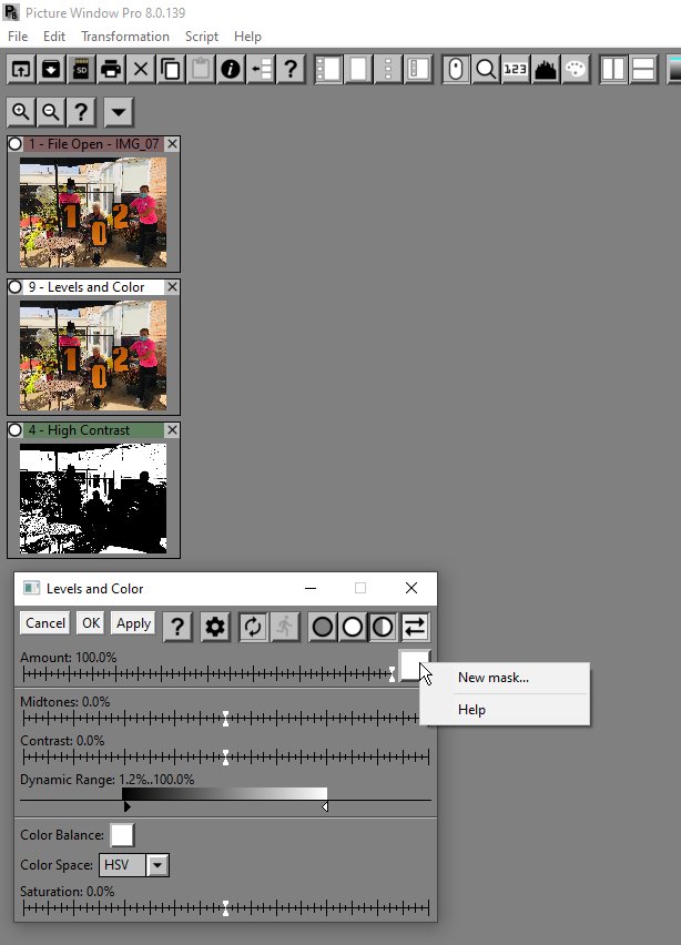

I'm sort of finding the same confusion:
Open an image, make an 8-bit black and white version with High Contrast
On the original image open Levels and Color and open the mask list - newly created black and white image does not appear on list:

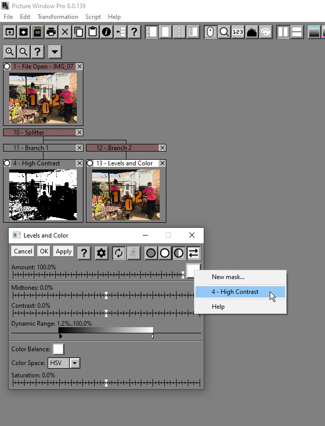

If I create B&W image, then open a branch from the original image, and then open Levels and Color, the new B&W image does appear on the mask list:

I think that the reason is that the mask is created as an output of the High Contrast transformation - so it doesn't exist upstream from it (otherwise a circular reference would occur).
When you create a side branch, or a new top-level branch, that solves the problem of creating circular references and the mask is visible in those branches, I believe.

The mask image can be in the same branch -- but it must be above (upstream from) the current transformation. If it is below (downstream) the mask would depend on the transformation that is using it and this would be create an infinite loop. Using a side branch as illustrated earlier in this thread is one way to avoid this. The other, more natural method is to create the mask from within the transformation that uses it via the Mask dialog box and its tool set. This is the PWP 8 equivalent to creating a mask in PWP 7 with the Mask command and then using it in a transformation. The potential problems arise when you use some other transformation (e.g. High Contrast) to create the mask as this requires a side branch to allow everything to happen in the right order.
