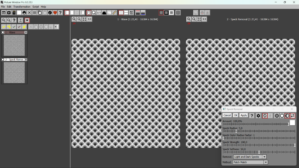

I reproduced the crash using a simpler scenario:
Create a dummy image using for example the wave transformation.
Invoke the tool "Speck removal" Create a few speck removal areas (using shift-left-click)
Choose the input and output preview mode
Repeatedly click on the Speck Radius scale ( faster than the computer can follow ) ... it could take many tens of clicks
PWP crashes
